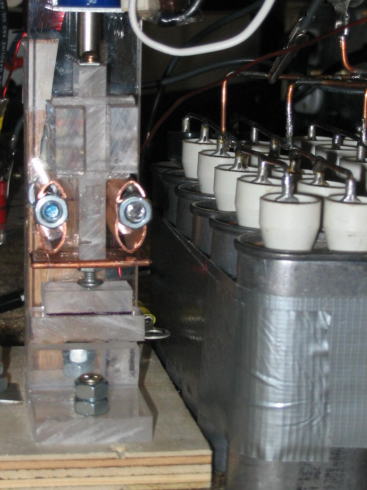

With these test figures in mind, I decided to see what MO caps are capable of.  The bank consists of 18 parallel caps, each rated 1uF at 2200VAC.  At 8kV, this amounts to 576J.  The switch is driven from a solenoid, and the contacts do not touch, but get *very* close.

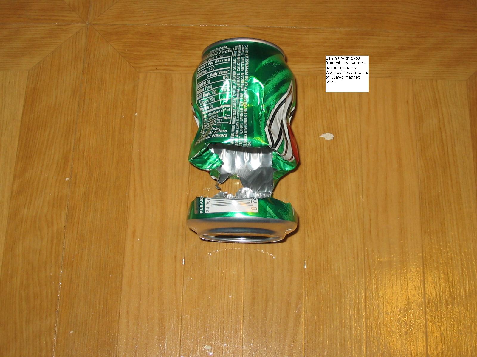

Would this be enough to crush a can?  Certainly!  Not only that, but it tends to rip the can apart.  Below are some pictures of my setup and a can.

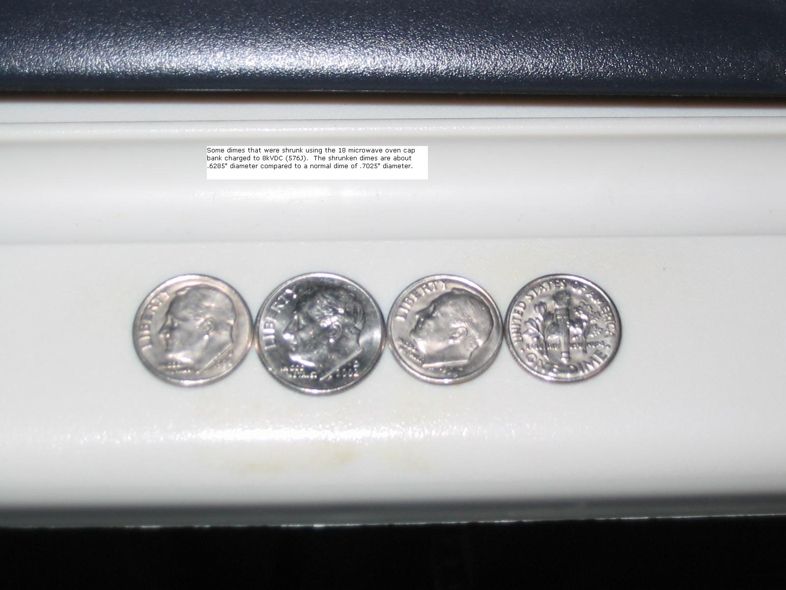

Ok, it can crush some flimsy aluminum, but how about a dime?  Yep!
This was with using 12 turns of 20awg magnet wire as the work coil.  Warning, wire shrapnel is very dangerous and must be properly contained!
