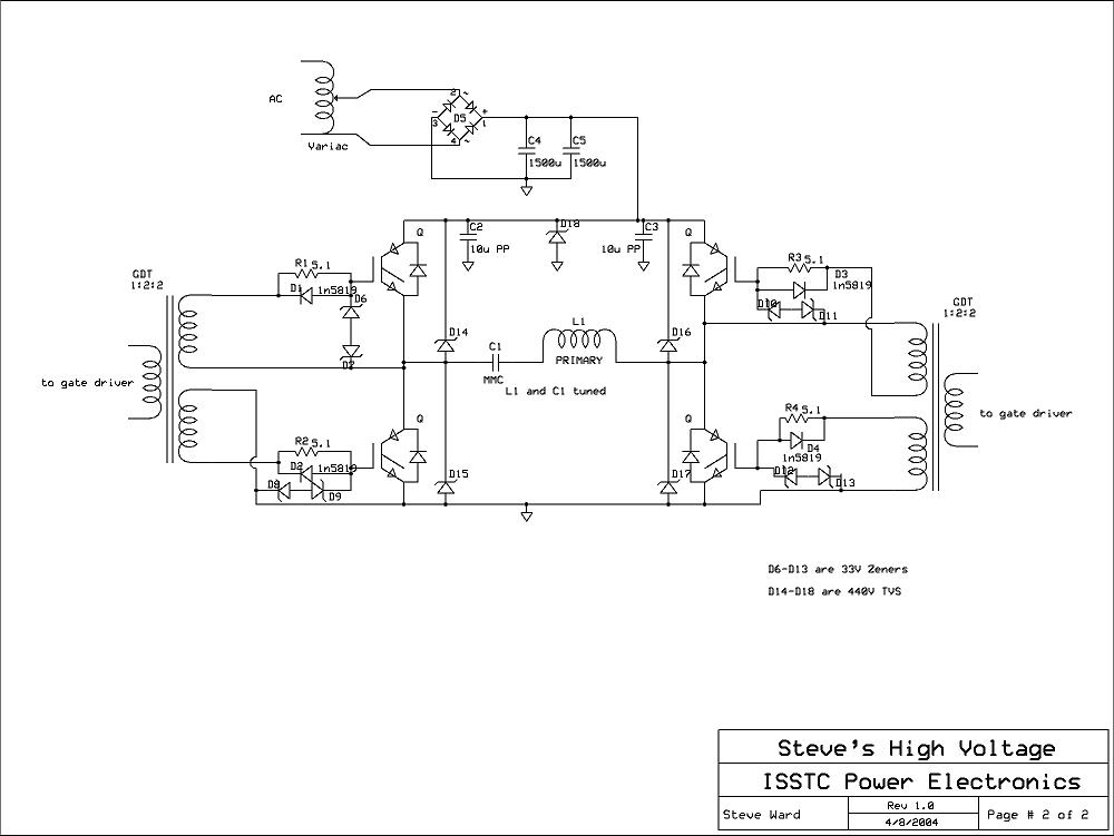

IGBT vs. MOSFET:
A question that I often get is "why IGBTs and why not MOSFETs?".  The answer is relatively simple, and it deals with the losses in each device.  A MOSFET has an ON resistance, so power dissipated in a MOSFET is given by I*I*R.  As I increases, the losses go up exponentially.  An IGBT on the other hand acts like a diode and has a relatively constant voltage drop, so power dissipated is given by V*I.  Losses go up linearly as current increases, and this really makes all the difference when running 100's of amps pulsed.  To further exploit the pulse capabilities of the IGBT, we drive the gates to a higher voltage (30V is typical).  This lowers the volt drop, and keeps the IGBT in saturation even at extreme conduction currents.

The best topology by far for DRSSTC work is the half-bridge or full-bridge.  The full-bridge offers a higher output voltage for the same input voltage, but at the expense of greater parts count.
Some tips for constructing your bridge inverter:
