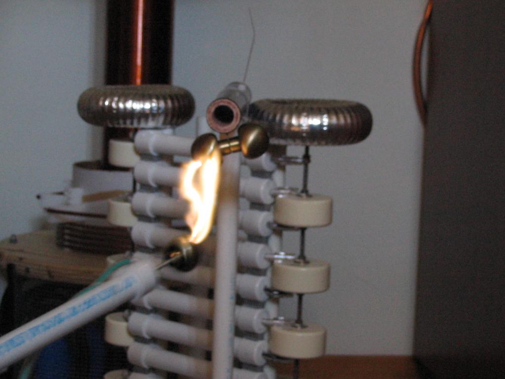

HV CAPACITORS:
I chose to use these HV doorknob capacitors (40kv 2nF) for several reasons. Firstly, I think they look pretty neat, and are very robust physically. Secondly, I could use them as an integral part of the mechanical design. The capacitors are held together with threaded rod. The diodes are also connected to this threaded rod. While this technique worked well for my first 2.5-stage design, it was a bit "wobbly" for the full 5 stages. I then went back and glued some 1/2" PVC to the capacitors and diodes, yielding a rigid tower structure. When building ultra HV devices, you must build upward to get the desired voltage stand-off (think about tesla coils). Below are some pictures of the completed CW tower.

FIRST LIGHT (12/15/04)
This was the first time I got the CW to produce sparks that I was looking for. The sparks can start at about 4-5" between the 1" spheres, suggesting perhaps 80kv or more. When the arc strikes, it can be sustained as a ghostly yellow flame. The 1" spheres get incredibly hot, suggesting that there is quite a bit of current. I measured the input power to be 750W (which is not a whole lot) and it drops to about 2W when I don't draw sparks. My transformer starts to let out a whine at 800W, I'm not sure why, but I know it's not good.
An interesting thing to notice is that in some pictures there are only some thin purple sparks. This occurs because of the sharp points on my ground electrode, behind the sphere on the end. These thin sparks are some 8" long, but do not allow for a continuous arc. When an arc is started, it can be drawn out to about 7" or so.

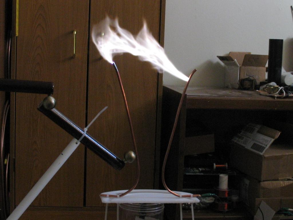

SECOND LIGHT (12/23/04)
I made a few changes to my setup. Firstly, I reduced my primary turns to 17 turns to get more V/turn on the transformer, hoping for higher output voltages. I think I havent even gotten much over 7kv or so out of the transformer so far. I then also built a voltage doubler to give me a maximum of about 400VDC on the bridge, assuming a very light load. I then also added an air gap to my transformer core, to avoid the risk of saturation. I also thought the core would increase the leakage inductance enough to limit my input power to a reasonable level, but that just isn't so! I managed 1800W of real power from the 120V line into the CW driver! This was achieved at around 300VDC input. The output at this voltage should be around 90kv unloaded from the CW. I'm not sure if I am actually getting that much voltage though. Anyway, this thing is pretty fun for making big arcs. I attempted to power a lifter with it, and it did work until an arc set the lifter on fire. I need several MEGs of output resistance to do more lifter work with this thing.
